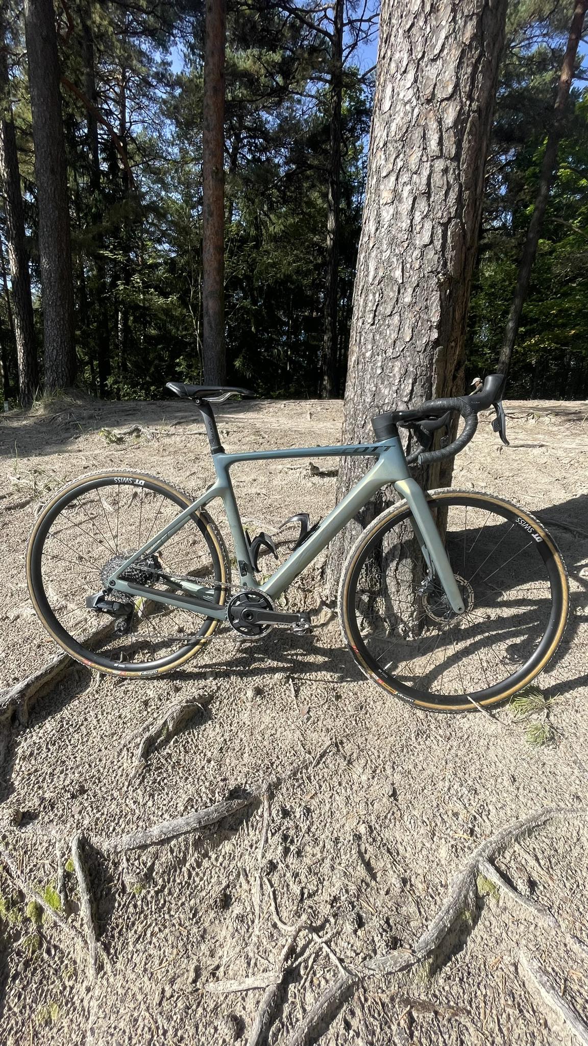

I replaced the handlebar with a road bar and the stem is now an internal routing one. I prefer this combination to the standard setup. The groupset is now a Shimano 105 Di2 with a Power2Max power meter. The 50-34 chainrings fit easily using a standard Shimano SM-BB72-41B bottom bracket. I don't know if SRAM has the same chainline.
Thanks for the information. Looks great by the way in green with 105 too. Pity there are no Shimano Di2 12s factory builds with road groupsets, they are waiting probably for the new GRX Di2. The chainline for FC-R7100 is 44,5 mm, for your power2max should be 44 mm and for RED/FORCE AXS it is 45 mm. So it should be safe to run ROTOR oval chainrings in desired size with any cranks with chainline 44 mm or more.plrww wrote: ↑Tue Oct 24, 2023 9:19 pmThe factory stem length on a size L Addict Gravel is 110 mm.
