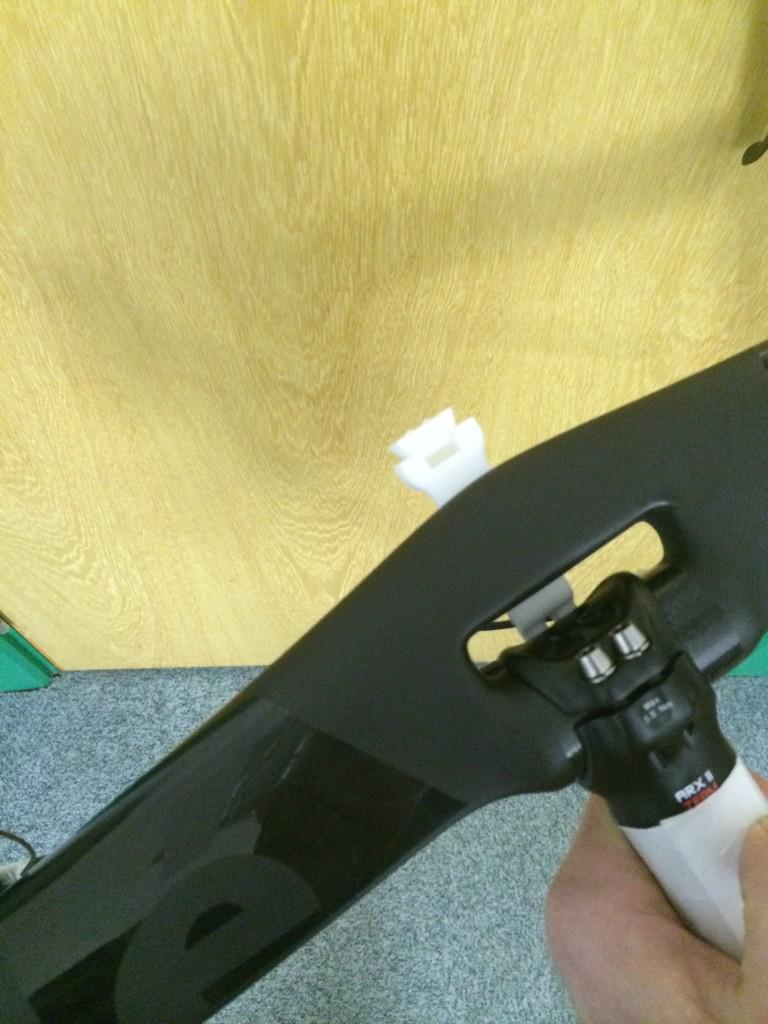

Just finished this up for a friend
GoPro Felt Aero Road 1.1A Seat Post Mount
I am trying out a few ideas about head design as well as the shape of the clamp so this is definitely a BETA product and if anyone buys one I would love feedback.
