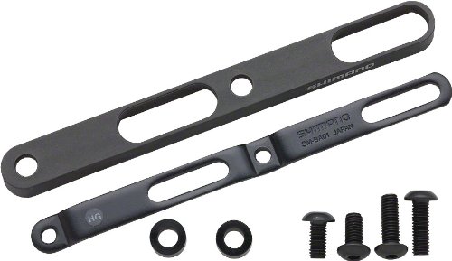

Instead of taping to the seat tube (I would be concerned on damaging the paint...) you could try a:
Di2 Junction 'A' screw on mounting clip
plus this:
Shimano Dura-Ace Di2 Seat Tube Bottle Cage Relocator
and don`t forget this:
Metric Nylon Pan Head Phillips Machine Screw - Part Number: 92492A320
plus this:
Thanks AndreLM. I am missing the big picture. I understand the use of the Shimano bottle cage relocator, but how would that work in conjunction with the Di2 junction A screw on mounting clip? Does the mounting clip just screw into the bottom hole of that bottle cage relocator? And then the water bottle cage goes into the oval sized holes?

@53x12 the tape on Di2 clip is curved for about a 36 mm circle. So it should work on most seat tubes.
53x12... I actually didn't think really well on how it would work before sending the suggestion, but Yes...you would use the relocator in a slightly different way.... You would screw the cage through the oval holes, and place the clip on the round hole on the relocator...
The relocator would not relocate the cage...
I am not 100% sure it would work
