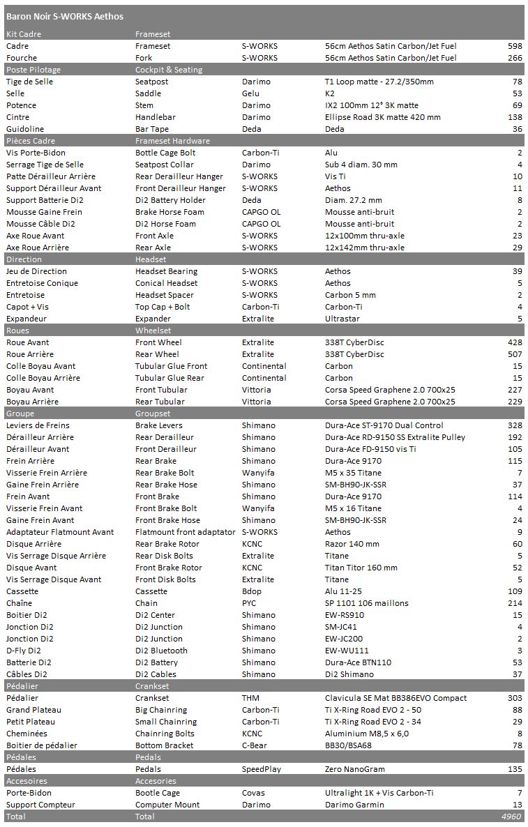

My last build, similar as my old Ax-Lightness with Lighweight Obermayer wheels but very most confortable...

Aesthetics - tick. Weight - tick. Detailed component breakdown of components and their weight - tick. Thanks @idinfo68

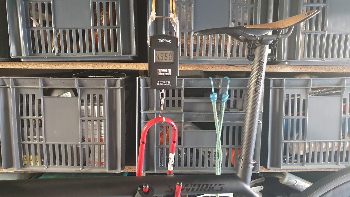

Curious to know if you've actually weighed the whole bike or your maths is just the sum of the parts weighed individually?
Just thinking whether the grease, brake fluid, air in tyres etc. have been accounted for and it is really sub 5kg? (not to put a downer on a fantastic build!!)
idinfo68
Posts: 136
Joined: Wed Nov 05, 2014 9:35 pm
by idinfo68
Hello,
All parts accurately weighed before final assembly.
3 weighings to check the final rolling weight :D
