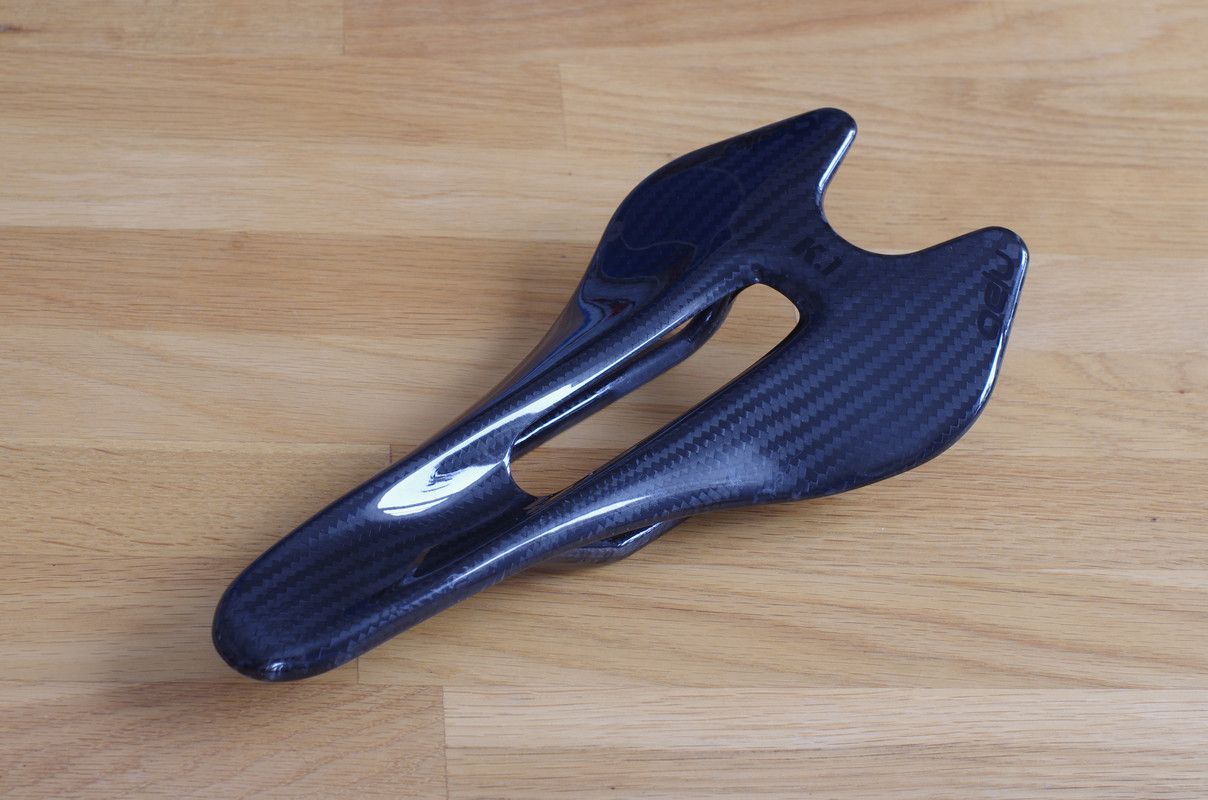

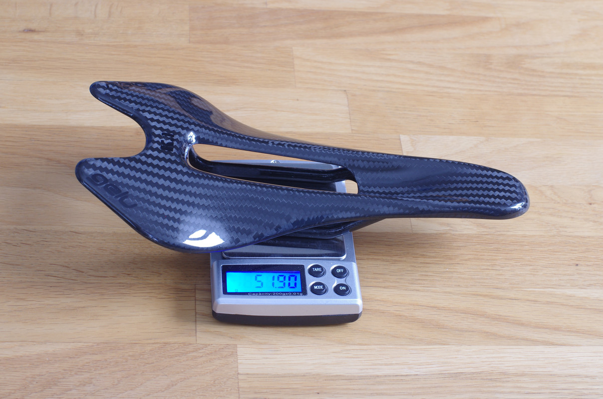

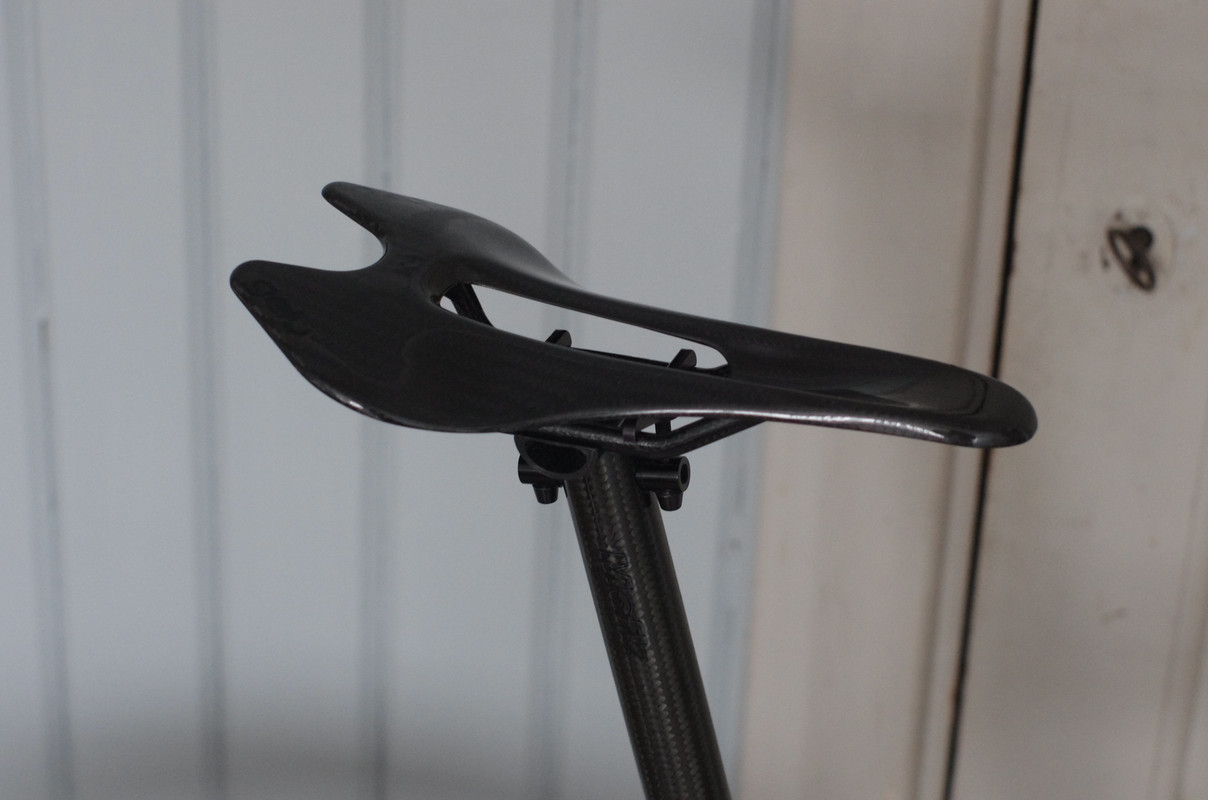

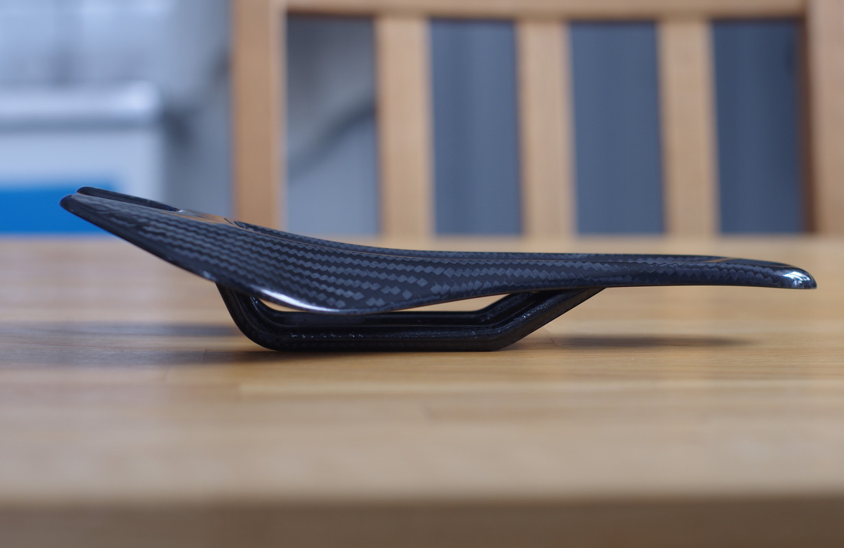

Got a new saddle for the R3, a ridiculously light Gelu K-1 at only 52 grams!!
Lucendi
Posts: 643
Joined: Fri Jul 19, 2019 10:37 pm
Location: Sweden
by Lucendi
I got the new Gelu K-1 saddle installed and have started using it on the trainer, so far so good!

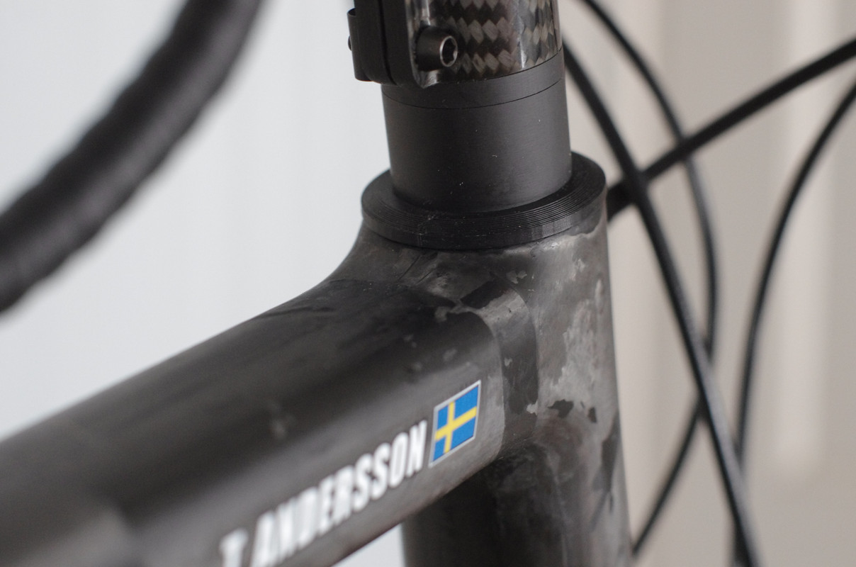

I installed a 3D-printed headset dust cover (saving about 10 grams!);

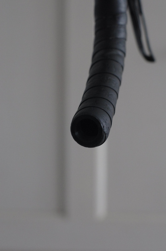

Some ultralight 3D-printed bar end plugs (1,8 grams for the pair!);

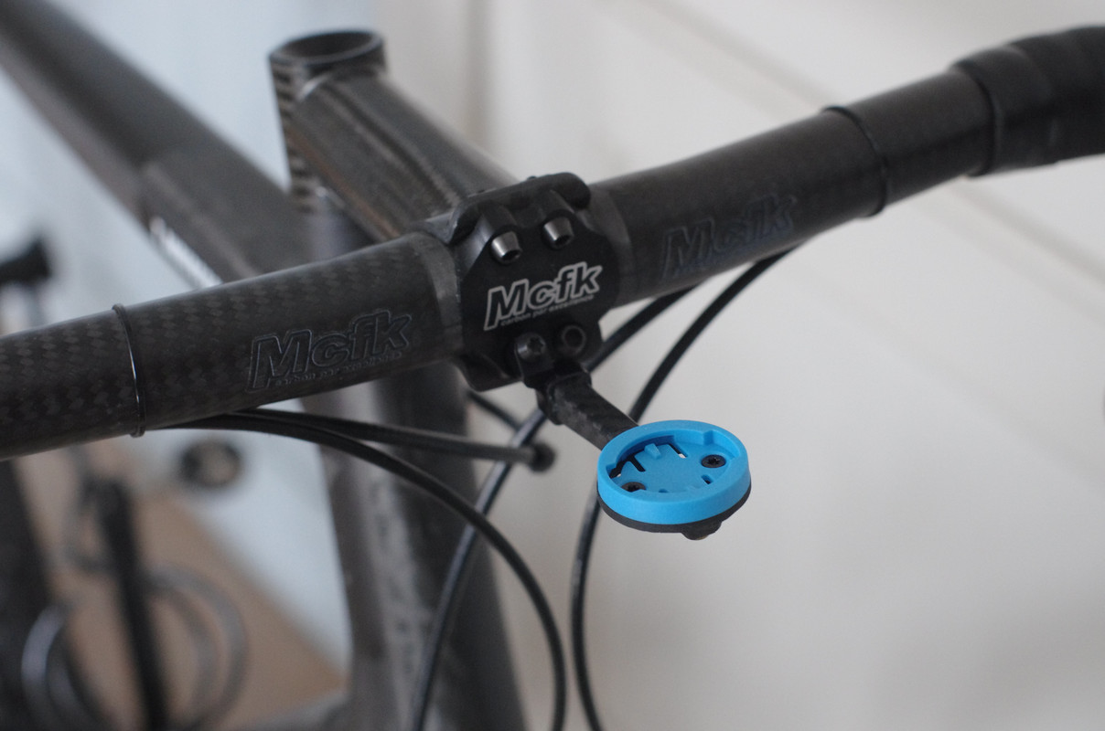

And the cockpit got a refresh with some stealth black MCFK decals, and an Alpitude Stelvio (small) computer mount;

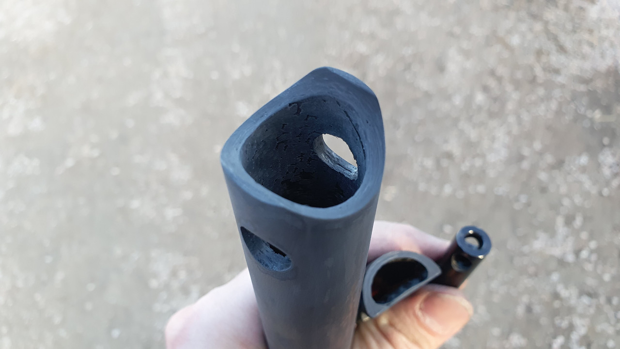

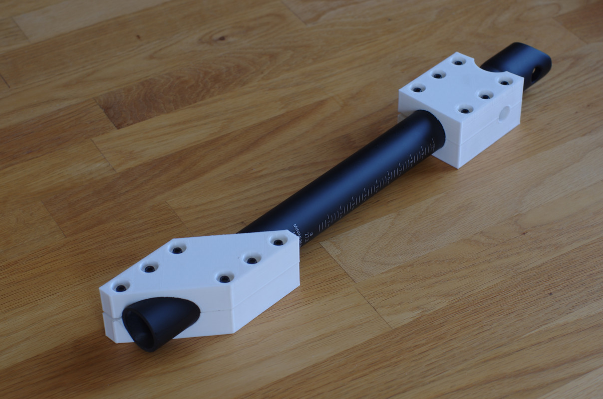

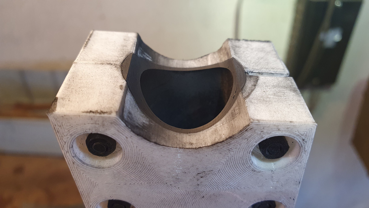

I replaced the broken MCFK seatpost with an Elita One after some modifications.
It is the same weight (+ 0,4 g) and only cost me 30€.
I reinforced the top by epoxying a carbon fiber tube insert to the inside to increase the wall thickness.
I applied a thin layer of 2K clearcoat, so thin the scale couldn't measure it (+ 0,0 g). :p
