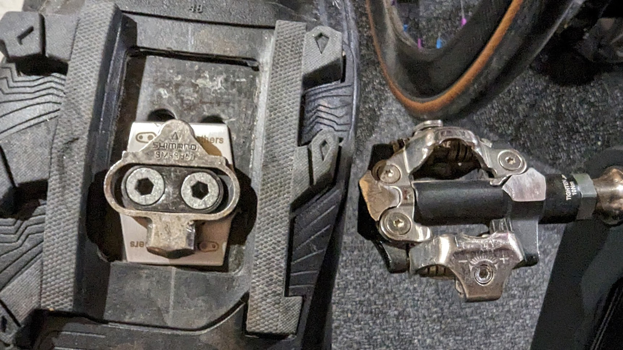

As a person with a very wide forefoot and doesn't like squished toes, Lake shoes are the only option for me (and even they are too pointy for my toes, but I have found cycling shoes that have a remotely wide to area.) While my Lake MX237 shoes and XTR SPD pedals work just fine, the combination is embarrassingly squeaky. Every time I get out of the saddle to climb a steep hill, squeak ... squeak ... squeak ... squeak :( Nothing like riding a $5k bike that squeaks like a department store bicycle!
Looking at the wear pattern on my shoes and pedals, it appears like the rubber "bumpers" on the shoes come in contact with the pedal surface when I put a lot of downward force on the pedals (I.e., standing while climbing). I have my pedals setup to be relatively loose to allow for float, so I'm assuming that's contributing to the sqeak issue.

you can use shimano specific spacer for non-carbon shoes:
for carbon shoes you can use crankbrothers "shoe shields" as a spacers:
Image Image
PoorInRichfield
Posts: 203
Joined: Sun May 17, 2020 9:38 pm
by PoorInRichfield
ooo wrote:
Sun Apr 10, 2022 9:56 pm
Those are interesting and might just do the trick. The Teflon spray didn't work on my Lake MX237s, even when just riding on my indoor trainer when my shoes never got dirty. I had tried cutting-away a little of the tread on the soles at one time, but it's super tough rubber and decided not to destroy the shoes for a squeak.

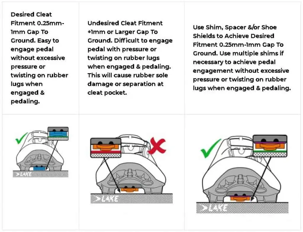

Saw this picture on a non-Lake website. Not quite sure how I can figure-out if my cleat 0.25mm off the ground, but this may explain all the squeaking I get from my shoes...

thewoodsman wrote:Lakes have a fairly deep recess for the cleat, so they can sit a little high, which can cause rocking/squeaking (separate from a squeaky cleat/pedal interface). Crank Bros candy pedals have spacers you can add to the contact area to take up the gap...worked well, but I never liked those pedals.
You can get a spacer to lift the XTR cleat higher to make it flush to the rubber sole. I had to add it on one of my gravel shoes. I forget which one…maybe it was my SW Recon.

Thanks to ooo for suggesting the Crank Brothers shoe guard as a spacer for my Lake MX237 shoes. I finally got around to getting a set because the squeak was making me nuts while training indoors. As suspected, they do the trick... no squeaks. (Although I feel a bit dumb not having done this years ago! :oops: ) Now that the rubber soles are no longer touching the pedals, the pedals do feel a bit "loosy-goosy", but quiet.
