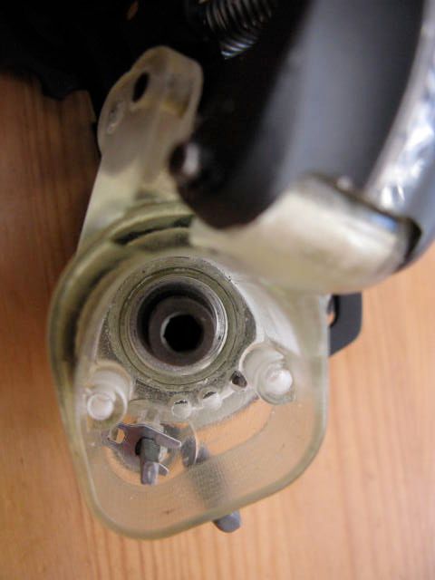

waiting for the finished parts to turn up but here is a quick teaser of the mech with RP parts.
it fits to the existing Ultegra Di2 mech armsand is designed so that it can be drilled tofit either the 6770 or 6870 mechs,
It uses the clutch and spring units from a Shimano mtb mech, these are all available as spares or by sacrificing an MTb mech such as a Zee +
more to follow when the finished parts come back from the RP company and anodisers.

Your right not required for road, but pretty useful if you gravel race or cyclocross, which is my intended use, i will also be using it on my MTB with a different cage, a One Up Radr cage, longer and offset pulley so it will work with 10 speed 11-42 or 11 speed with XT 11-42 cassette for a budget Di2 mtb setup.
As promised some more photos and info,
It runs the clutch, cage spindle, lever, spring and seal from a deore mech, in this case mated to a modified road cage, this keeps the offset top pulley that you would loose if you ran a Saint or Zee MTB short cage. So effectively the mech is the same as an Ultegra mech except for the clutch.
The main body and lid are in an EOS sintered Nylon12 RP material with very high strength, this then has new brass pivot bushings for the pivots with an Aluminum aero grade rivet for the lower pivot pin and the upper pivot pin and seals are reused from the Ultegra mech. the cage spindle runs in a pivot bush made of Aluminium 6082 T6 with a reamed bore which is then hard anodised.
http://i63.photobucket.com/albums/h159/ ... laio83.jpg
http://i63.photobucket.com/albums/h159/ ... olzvkf.jpg
http://i63.photobucket.com/albums/h159/ ... omsg83.jpg
http://i63.photobucket.com/albums/h159/ ... jybfbu.jpg
http://i63.photobucket.com/albums/h159/ ... sxukdv.jpg
http://i63.photobucket.com/albums/h159/ ... fkkf2d.jpg
