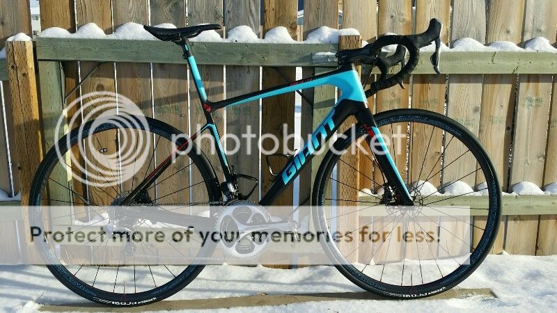

New bike day for me! I treated myself to a new ride for my birthday, and was able to pick it up last night and take it for a ride this morning. I am coming from a Propel Advanced w/Ultegra and although the 105 group set here is a downgrade, I see the differences as marginal, although Ultegra feels slightly better.
http://i.imgur.com/ttqkowp.jpg
The bike weighs 8.95kg stock with my pedals, and PRO Carbon rail saddle, and I'm looking to drop some weight. I've already ordered a set of Yoeleo carbon wheels. My plan for this bike is to swap out to eTap once SRAM releases the hydraulic version, however I may upgrade the crank sooner than that. Trying to decide between an ultegra 6800 or Easton EC90.
Other ideas I have:
• SRAM eTap Hydraulic (when it's available)
• Crank upgrade Ultegra 6800 or Easton EC90, but would love other suggestions!
• TI bolts
• Better discs (Shimano XT Ice-Tech)
• Green bar tape
• Giant SL D-Fuse seat post (this likely won't save me much in terms of overall weight)
• Carbon stem and bars
Wondering if anyone else can help me reduce the weight here, particularly in the rear end, as I find it's most weighty in the trunk!
Thanks!

Nice Defy! Love the colour scheme. I have my Defy down to 6.85 kilos. What is your goal? The wheels will go a long way to dropping weight. If you care about shifting performance you really can't beat shimano cranks though they definitely lack the bling factor (although I think the DA cranks look pretty awesome). Maybe go for SRAM cranks if you are planning an etap build?
Benno wrote:Nice Defy! Love the colour scheme. I have my Defy down to 6.85 kilos. What is your goal? The wheels will go a long way to dropping weight. If you care about shifting performance you really can't beat shimano cranks though they definitely lack the bling factor (although I think the DA cranks look pretty awesome). Maybe go for SRAM cranks if you are planning an etap build?
Woah! Impressive weight, is it a disc version? I dont know if i'll be able to go that low, but I would be ecstatic with anything under7.5kg.
Yeah mine is a 2015. I lost a kilo off the weight just with wheels alone.
I did Ti bolts and used the lighter steerer expander that was included with the bike. Also the seat is pretty light. I normally use ashima rotors because I like a grabbier brake. Skewers are from Tune and fairly light as well.
Be warned the very light stuff like Ti/ALU bolts, light skewers, light carbon seat are all pretty fragile and require a gentle hand and constant inspection.

I had my old Giant TCR Advanced (not SL and not disc) at 6.63 kg with SRAM Red shifters and derailleurs and Zero Gravity brake calipers pedals, bottle cages, and computer. 1250 g Al wheels. Nothing too special. It isn't really that hard.

Yeah, but you're talking about a 5 lb difference. You can't blame that on disc. My frame weighed a massive 1,235 g and I still managed a very respectable weight. So i'm just saying you can get very light with just a little work. If disc is that porky, it simply isn't worth it.

Nice gift! I myself also just purchased a Defy Advanced Pro 2, it's got a similar build to yours, except for hydraulic brakes, Ultegra cranks, and shorter cage. Sharing my weight loss path:
Upgrades thus far:
1. Reynolds Attack Wheels (saved over 400g from the Giant SL1 wheels)
2. Specialized Toupe Pro (from an old build)
3. Avid HS1 Rotors
Upgrades planned in the next few days:
1. Ti Bolts all around (down maybe 20g)
2. Ashima 140mm rotors (another 12g from the HS1)
3. Specialized Toupe S-Works (another 10g down)
4. Giant Connect SLR 1-piece cockpit (saves just 50-60g but I'd like a similar front end as my TCR)
5. SRAM Red 11-28 cassette (saves around 80g from stock)
6. Carbon Ti skewers (less 70g)
7. Giant Carbon Cages (less 25g from the bonts installed)
I reckon I can get mine down to 7.5kg (including pedals and stages PM) from all-stock 8.4kg without pedals. Not sure if I can go considerably lower than that unless I switch out the cranks.

Defy advanced 2 is a nice bike. I got it previously, but at 9kg stock, I realised there's far too much effort (and money) to get it down to sub 7kg. Took a slight loss, and changed to another bike.
Still, nice n comfy bike.
